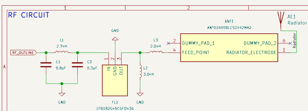

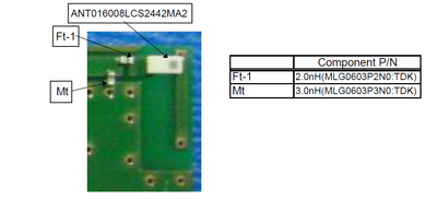

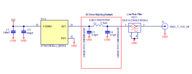

I'm designing an RF circuit using the STM32WB55CUG7 microcontroller and a ceramic chip antenna (ANT016008LCS2442MA2). However, the antenna circuit isn't working, as it doesn't show the Bluetooth name in the mobile application. I'm referring to the STM32WB55CUG7 module schematics to design my RF circuit, but the circuit I designed isn't functioning. Interestingly, the same design works perfectly on the STM32WB55CUG7 USB dongle board. I've attached my RF design schematic along with the reference circuit from the STM32WB55CUG7 module schematics and antenna matching circuits. Could someone please help resolve the issues in my design? Thank you...
My schematic diagram
