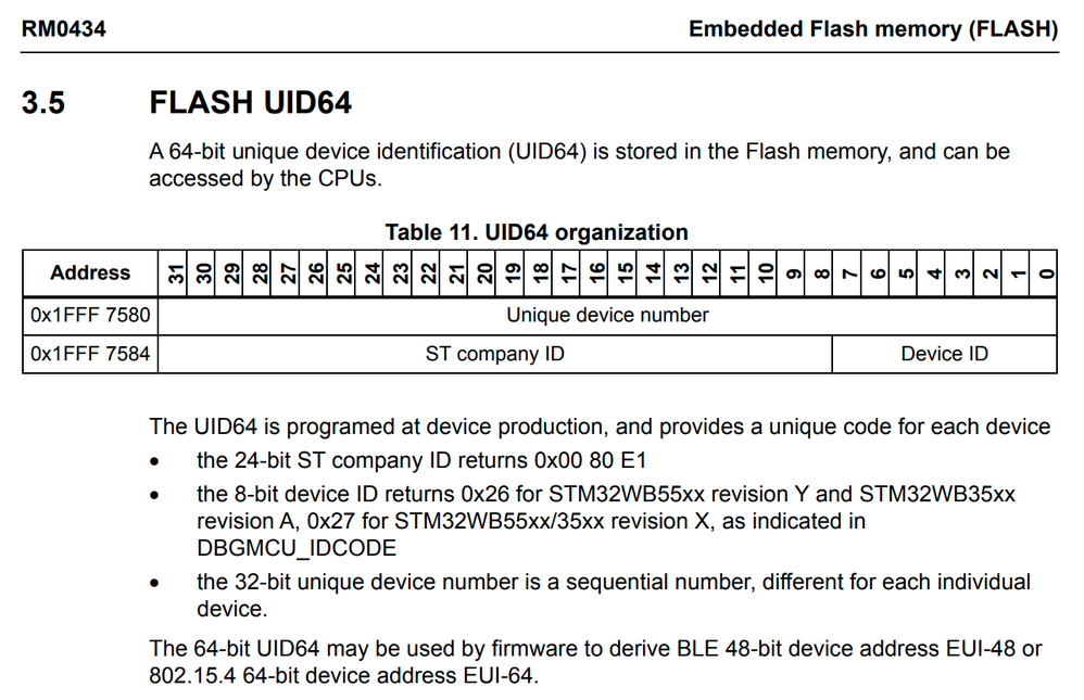

The reference manual lists the location of the 96-bit UID and the UID64, which is probably what you want.

How would I access this?
2021-12-23 10:56 AM
uint32_t uid64_1 = *((uint32_t *) 0x1FFF7580);
uint32_t uid64_2 = *((uint32_t *) 0x1FFF7584);
