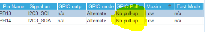

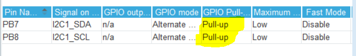

Just I notice that for I2C1 I have
and for I2C3
But I cannot change that.

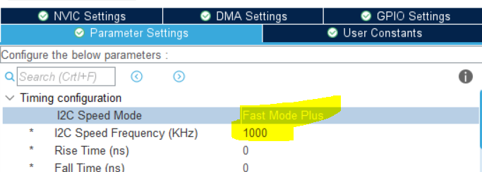

I have try to put Fast mode to try the high speed as said here : HAL for I2C is horribly broken (st.com)

Do you have an external pullup on the line? The internal pullup of ~40kOhm is insufficient for I2C in general, but especially for 1MHz mode.

I have checked using CubeMX 6.4.0 and issue doesn't appear, you can change set GPIO pull up for I2C2 and I2C3 signals, please switch to the latest version, if you still face a problem, don't hesitate to mention it.

Yes, 4k7 pullup. I use standard mode. The 1MHz mode is just to try that "HAL for I2C is horribly broken (st.com)"
