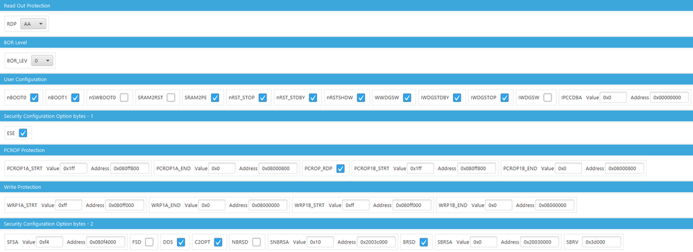

2025-08-14 11:23 PM
The option bytes are:
and the FUS information is:
We use both the FUS firmware and the stack firmware from stock firmware downloaded by the STM32CubeIDE. The MCU is STM32WB55RGV6.
