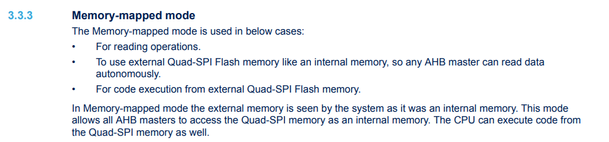

As mentioned in AN4760 section "3.3.3 Memory-mapped mode", in Memory-mapped mode the external memory is seen by the system as it was an internal memory. This mode allows all AHB masters to access the Quad-SPI memory as an internal memory. The CPU can execute code from the Quad-SPI memory as well.
