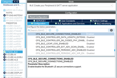

The aci_gap_set_security_requirements() command return an error with the code 0x11 that means a BLE_ERROR_UNSUPPORTED_FEATURE if KeyPress_Notification_Support is set to 1 but Secure Connection feature is not supported. Those two parameters are configured throw CubeMX and you can solve it by setting the CFG_BLE_SECURE_CONNECTIONS_ENABLED to Enabled (set by default to Disable on CubeMX):

Thanks. The problem has been solved by this modification.
