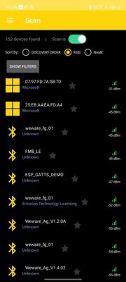

Yes, the phone is able to discover other things advertising. please find the attached screenshot for your reference as follows:

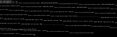

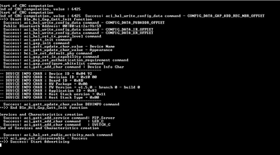

1> Serial logs of the STM32WBA55 nucleo :

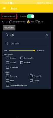

 3> Screen shot of ST tool box on phone with "p2p" filter
To make your serial log easier to read, reconfigure the terminal to do a Carriage-Return when it receives a Newline.
I am sorry for the inconvenience caused.
PFA>
