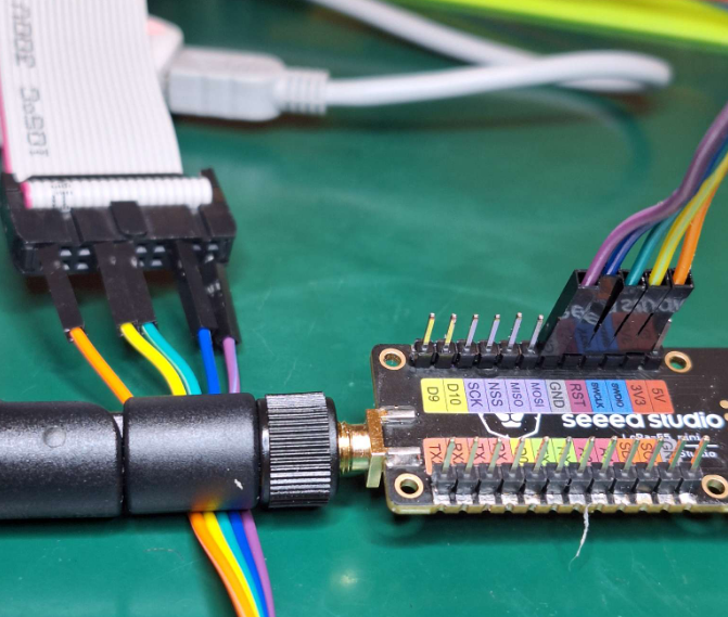

I have two devices: one is the Lora E5 MIni, and the second is the Lora E5Dev board. Both respond to the AT commands, so I expect they are healthy.
A few days ago, I could access these devices and see their memory. Today, I can't, and I don't know why.
I connected the programmer to the dev board as needed, and I can't connect to this device.
I tried to change settings as the other programmers suggested to achieve connection to such devices but without any success. Programming STM32 controllers using ST-LINK V2 is a kind of magic. It's a horror for me. I can't program my devices.

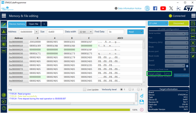

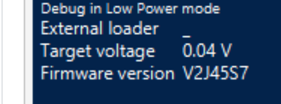

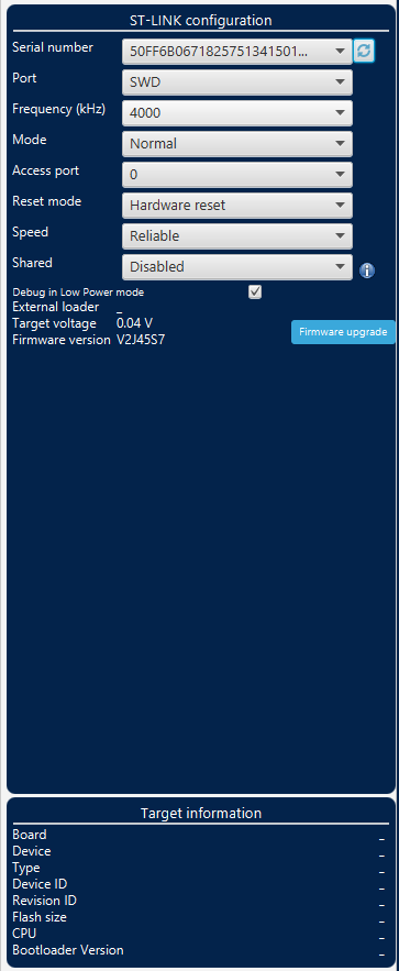

From the ST-LINK, it looks as expected, I think:
As I wrote above, changes of modes and reset modes gave no change.
So, what is wrong? ST-LINK answers on connection, but why it doesn't see devices connected to it?

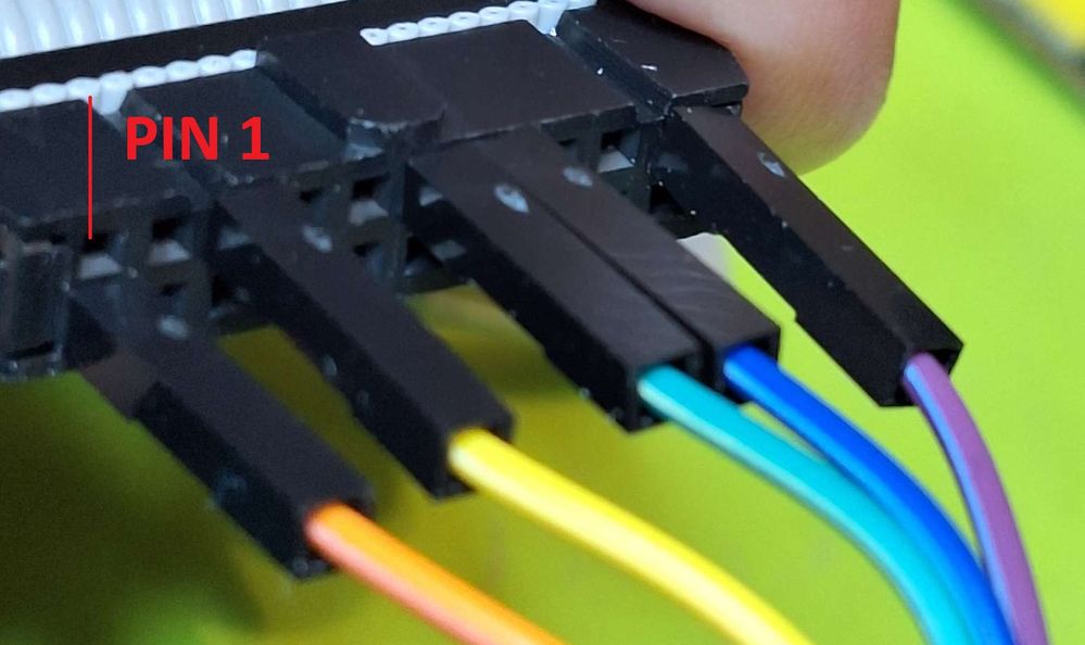

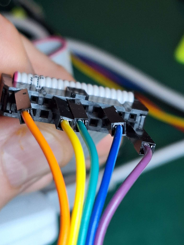

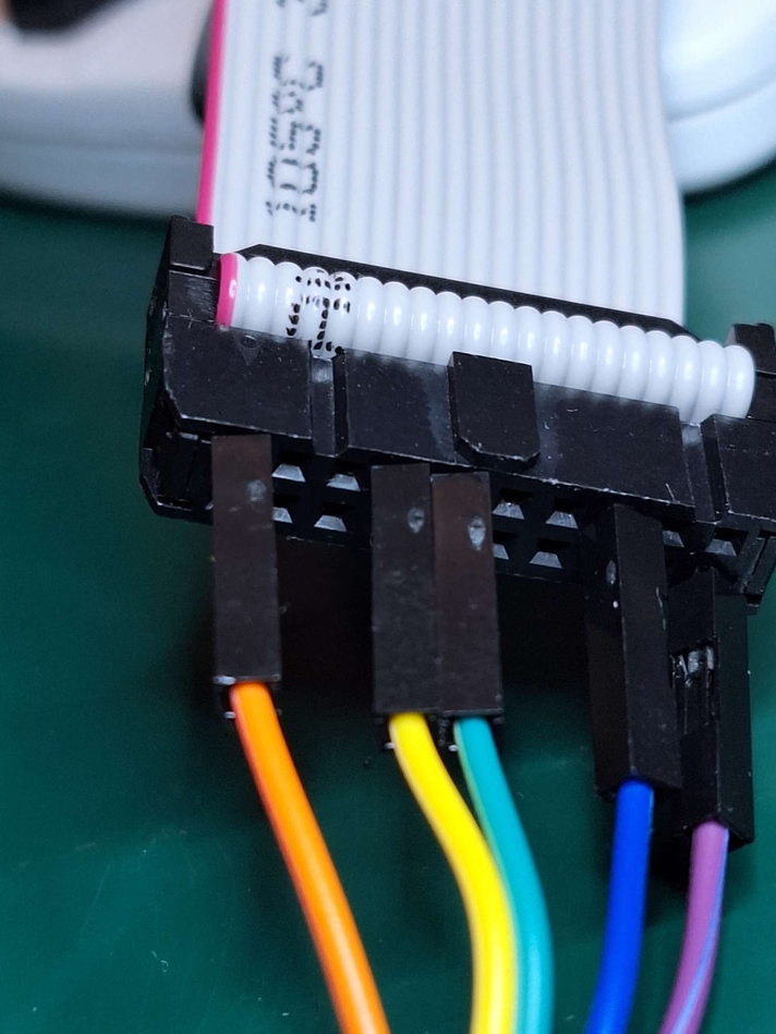

Did you switch the colours around? I'm seeing GREEN into PIN 1, on your Target PURPLE is 3V3, GREEN is SWCLK, ORANGE is GND
On the gray cable I'm seeing ORANGE into PIN 2
The connector/keying of the cable is mirroring that of the PCB pins

How are you powering the board?
The Pin 1/2 are an input of VTarget to match the voltage via buffering.
The STM32 Cube Programmer tells you the measured voltage, as 0.04V it should be the 3.3V there.
You can power via your USB connection.
You can pull 3.3V from Pin 19 of the ST-LINK.
Other than that, does look correct
If you had broken the board earlier, it likely won't connect now.

For the first case, the target voltage changed from 3.24V to 3.26.
For the second case, the target device was 3.25V.
For the third case, the target voltage was 3.27V.
It seems that STM32CubeProgrammer doesn't accept a target voltage lower than 3.25V.
Hello, STM32CubeProgrammer team. Would you consider changing the message displayed by this tool when the target voltage is too low? The current message, "No STM32 device found... " is not adequate to the situation causing the problem.

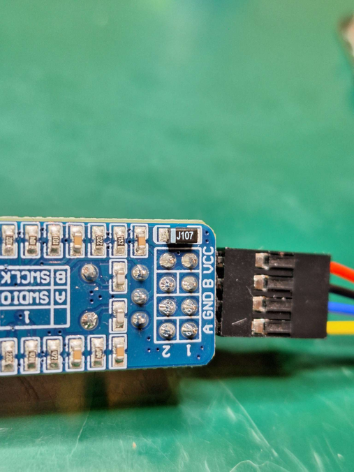

@TDK No, ST-LINK V2 Mini from WaveShare has its power supply to the device, look:
It also works with or without giving the power supply directly from the USB.
The same was true for the former ST-LINK V2 ones from STM32, except for this one, which I mentioned in this thread.
