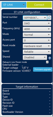

From the ST-LINK, it looks as expected, I think:
As I wrote above, changes of modes and reset modes gave no change.
So, what is wrong? ST-LINK answers on connection, but why it doesn't see devices connected to it?

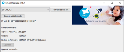

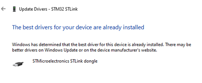

I bought the new brand ST-LINK V2. I upgraded it successfully:
The driver to it is actual:

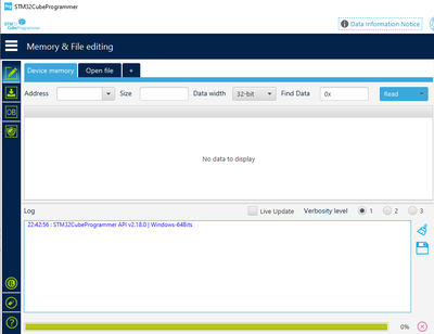

I use the ST32CubeProgrammer:

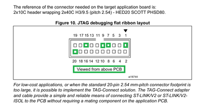

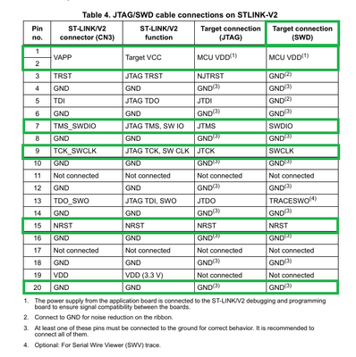

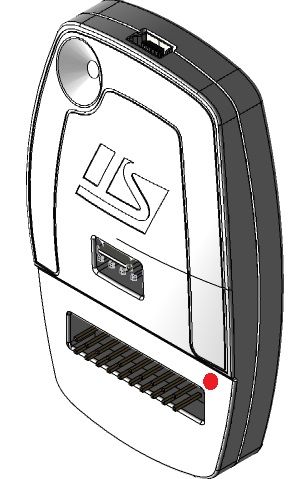

I've got pinouts for this programmer from the official link:
According to the above document, the order of the pins looks like this:

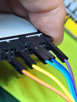

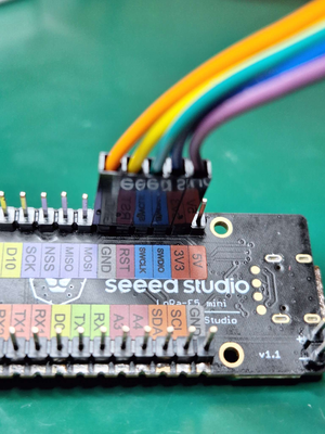

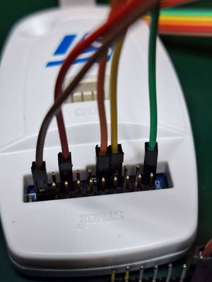

So I connected wires to the Lora E5 Mini:

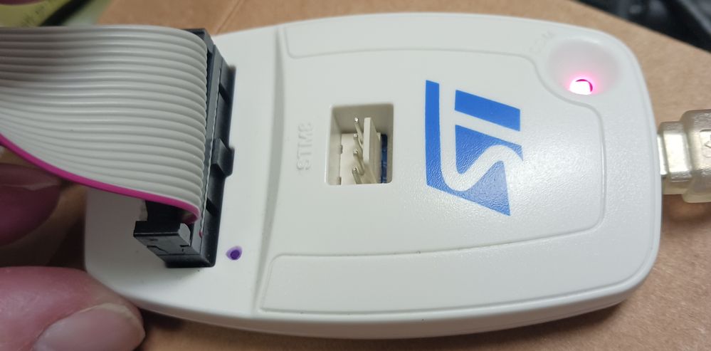

And to ST-LINK V2 (from the point of view the ribbon):
I have got the the result:
So nothing changed:
Next, I connected wires from the point of the pins on the board:
Connections to the Lora were the same as above (the target voltage is 0V in this case).

2025-01-10 2:38 PM - edited 2025-01-10 2:46 PM
Both those connectors to the ST-LINK look backward.
Look at the diagram again
Pin ONE is the RED DOT, and RED LINE on the cable
2025-01-10 2:50 PM
Look at the last picture of my last post. I made the connections assuming that the first pin is in the right upper corner. The second is in the row below. Ans so on.
So exactly the way as you point out. Am I wrong?
