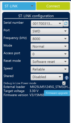

Coul you please try to connect this board using those parameters (and all other parameters combinations even debug in low power mode):
Also, Check the jumper positions: JP2 ON, JP1 on USB_STLK [1-2].
Best Regards.

thanks for your comments! All jumpers were at their right position, but I additionally connected the JP1 jumper on the MB2032 MCU RF Board. I dont know if that was necessary?
After some trying with different settings and unchecking "Debug in Low Power Mode", I could connect to the MCU.
It seems it's working now!
