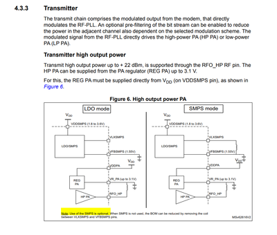

Hello @viola
As you can see on the chapter 4.3.3 of the RM0461, the transmitter for high output power does not need SMPS to be configured :
For the CubeMX part, can you please give more details (how to reproduce).
Best Regards.

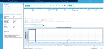

2024-11-06 2:52 AM
Hi ,
As you can see in the picture below , I dont have the option for "high power" when "SMPS" is OFF
2024-11-06 3:33 AM
Thank you so much for this escalation. It is sent to the CubeMX team for update on the future (under internal ticket number 195795). That may depend on the available data for simulation (test results...) .
Best Regards.
STTwo-32

2024-11-11 7:15 PM
Hi STTwo-32,
Regarding the Internal ticket - I just want to add that you can see the problem even if you open example code for the nucleo board in the cubemx for STM32WL that uses the subghz block and you will see the problem.
