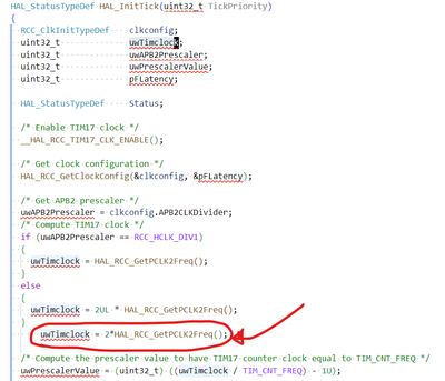

When "Middleware and Software Packs" > STM32_WPAN is enabled in CubeMX, a duplicated initialization's code for uwTimclock is generated:
That code is outside the if-else block overriding the previous configurations which could produce issues.
Note: I attached the .ioc file.

Hello @mpc and welcome to the ST Community.
I've been able to reproduce this behavior, and I've reported internally for correction on the Future (under internal ticket number 206323). Thank you so much for your contribution.
PS: this has been solved on the version 6.15.0 of the STM32CubeMX.
