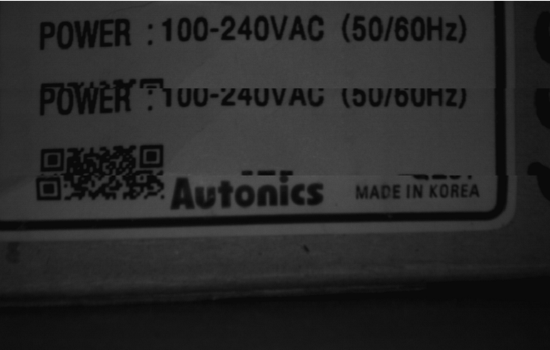

I'm trying to get an image from a camera with a resolution of 752x480.
In this case, the size (752 * 480) / 4 = 90240 exceeds the maximum DMA transfer length 65535.
And I get a broken image:
1/4 of the image is duplicated.

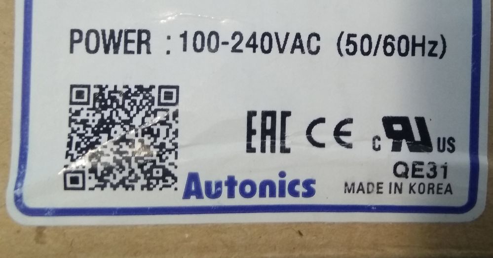

Original image:

HAL_DCMI_Start_DMA( &hdcmi, DCMI_MODE_SNAPSHOT, (uint32_t)buf, 752 * 480 / 4 );Does DCMI in STM32L4R7 support this resolution?
If so, what could be the problem?

eng23, thanks for your reply.
I compared the files stm32f7xx_hal_dcmi.c and stm32L4xx_hal_dcmi.c, it looks like there is no DMA double buffer mode in STM32L4.
However, the description and source code of HAL_ADC_Start_DMA handle the situation when the dma transfer length is greater than 65535:
* @note In case of length larger than 65535 (0xFFFF is the DMA maximum transfer length),
* the API uses the end of the destination buffer as a work area: HAL_DCMI_Start_DMA()
* initiates a circular DMA transfer from DCMI DR to the ad-hoc work buffer and each
* half and complete transfer interrupt triggers a copy from the work buffer to
* the final destination pData thru a second DMA channel.
