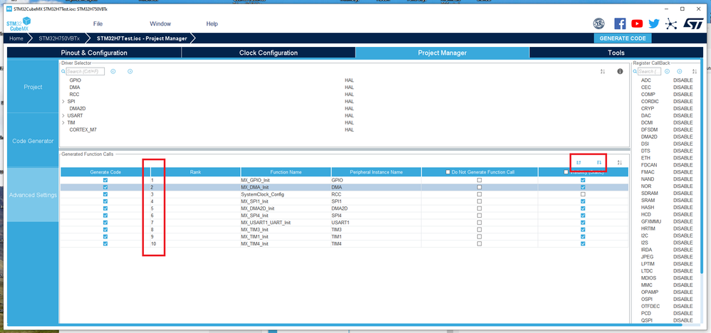

2022-01-17 12:27 PM
Do you do the swap of the init manually in the program or do you do it in stmcubemx in the Advanced Settings of the Project manager?
2022-01-17 2:20 PM
@PDeff.1 Yes, if you change it in code it will become wrong again when regenerating code. Fixed it permanently by this:
Opened *.ioc file in text editor and rearranged the 'ProjectManager.functionlistsort' to correct order.
2022-01-17 5:25 PM
Just change the rank of the function in the project manager to permanantly affect the project ioc file after rebuilt. No need to manually edit the file
2022-01-18 1:21 AM
Hi @PDeff.1 & @EGoep ,
In order to permanently fix the issue while regenerating code, you can refer to the post MX_DMA_Init order in the main.c file generated by STM32CubeMX, How to fix?
-Amel
2022-01-18 1:40 AM
thanks for the tip, this bug is also present in stm32wb and stm32f2xx packages that i know of
2022-01-18 2:09 AM
Dear @eg7963 & @Javier Muñoz ,
A pinned post is published some time ago under STM32CubeMX topic in order to describe the permanent solution for this regression issue.
Please have a look to MX_DMA_Init order in the main.c file generated by STM32CubeMX, How to fix?.
-Amel
