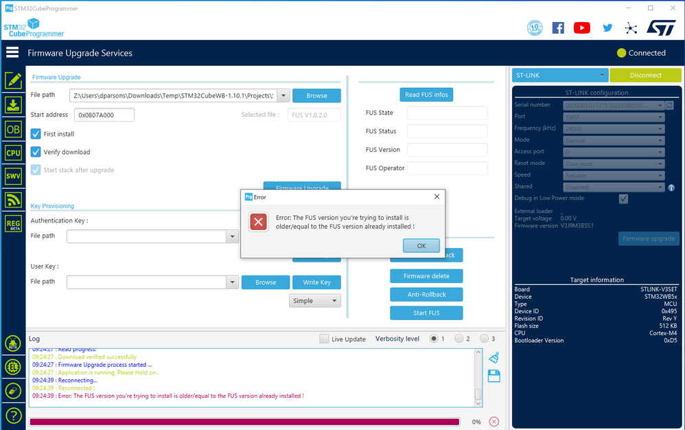

I'm having a similar issue...
https://community.st.com/s/question/0D53W00001Fmu49SAB/unable-to-successfully-load-ble-firmware-because-of-fusimagenotauthentic-so-my-code-is-failing-in-shcic2bleinit
I tried reverting back to 1.0.2 but it just tells me that I already have a newer version installed.
0693W00000HojIrQAJ.png@Remi QUINTIN​ , if I have one of those old decryption keys that does not match the new stack how do I update that key?

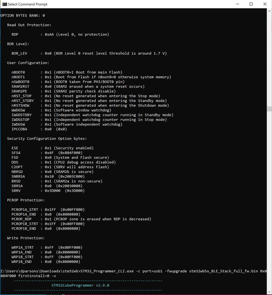

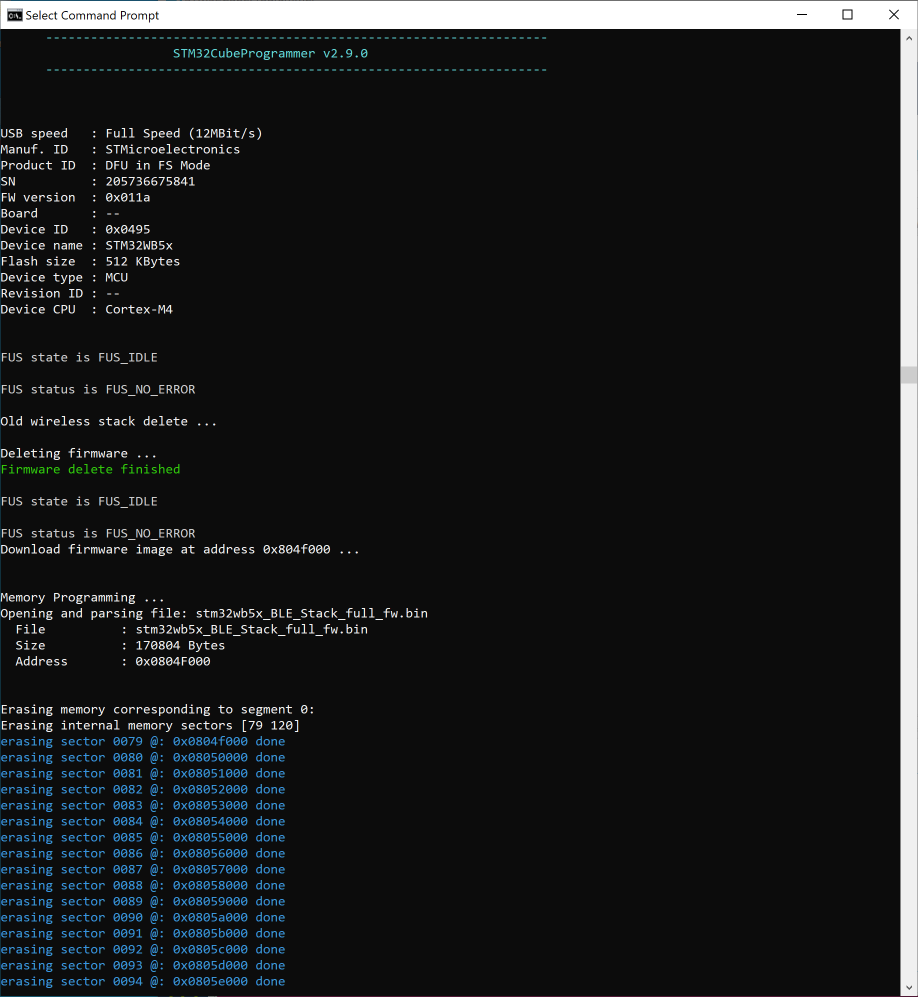

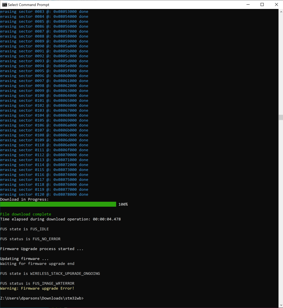

One thing I did notice during command line programming that I hadn't be before is that for the STM32WB5xxE (512K part I'm using) the FUS for 1.12.1 is supposed to be placed at 0x0807A000. I'm loading stm32wb5x_BLE_Stack_full_fw.bin which is 170804 bytes so it takes up 42 memory segments. If I place it at the recommended location of 0x08056000 it erases and programs through section 0x0807F000. Obviously this just writes over the FUS code. So I moved the BLE firmware to 0x0804F000 so that it ends before the FUS. It actually worked on one of the boards that I'm having an issue with but on a couple of others I'm not getting a flash write error (FUS_IMAGE_WRTERROR).
Here's the command line printout:
I actually don't think this is how this works, but I was able to successfully write the BLE firmware by trying different start addresses and different size files (full, light and basic versions of BLE).
