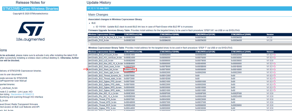

When i click firmware upgrade
\STM32Cube\Repository\STM32Cube_FW_WB_V1.12.1\Projects\STM32WB_Copro_Wireless_Binaries\STM32WB5x\stm32wb5x_BLE_Stack_full_fw.bin

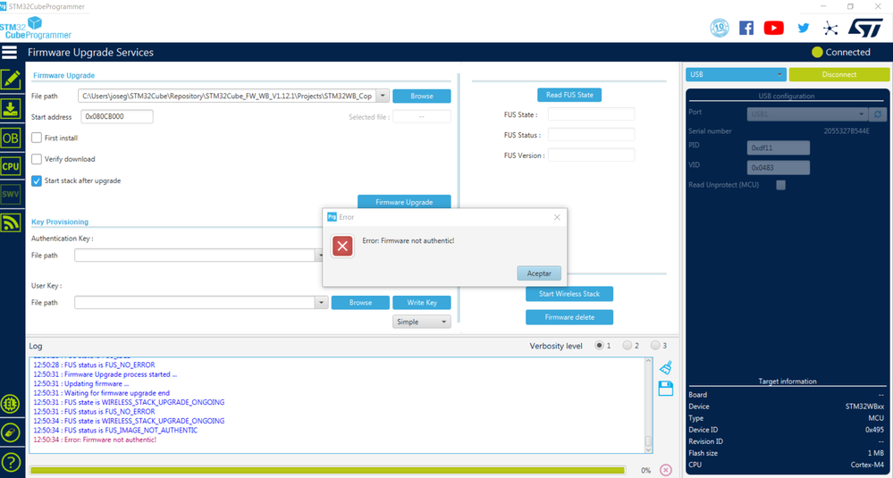

i get this Error: Firmware not authentic!0693W00000DmWwUQAV.pngthe firmware start addr in the video is outdated, with fw v1.12.1 the correct addr is 0x080CA000 but still same result:
0693W00000DmX6oQAF.pnglogs:

      13:07:12 : Firmware Upgrade process started ...
      13:07:12 : Updating firmware ...
      13:07:12 : Waiting for firmware upgrade end
      13:07:12 : FUS state is WIRELESS_STACK_UPGRADE_ONGOING
      13:07:12 : FUS status is FUS_NO_ERROR
      13:07:15 : FUS state is WIRELESS_STACK_UPGRADE_ONGOING
      13:07:15 : FUS status is FUS_IMAGE_NOT_AUTHENTIC
      13:07:15 : Error: Firmware not authentic!

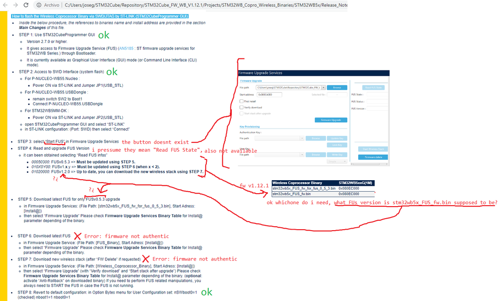

The main issue was, i was using cubeProgrammer v2.6 instead of v2.8, all the documentation made no sense to me because of that.
But i managed to do it with v2.6 :
AFTER TWO DAYS I found the correct rain-dance
https://electronics.stackexchange.com/questions/532179/stm32wb55-nucleo-fus-state-img-not-found-error/532227
first i needed to download a previous FW package flash the Fus firmware 1.0.2
C:\Users\joseg\STM32Cube\Repository\STM32Cube_FW_WB_V1.10.1\Projects\STM32WB_Copro_Wireless_Binaries\STM32WB5x\stm32wb5x_FUS_fw_1_0_2.bin
After that i was able to flash stm32wb5x_FUS.bin in 0x080EC000
\STM32Cube\Repository\STM32Cube_FW_WB_V1.12.1\Projects\STM32WB_Copro_Wireless_Binaries\STM32WB5x\stm32wb5x_FUS_fw.bin

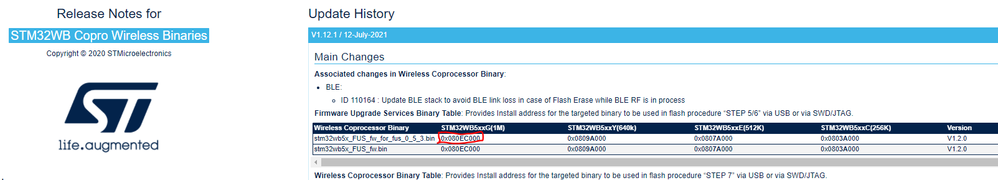

Fus update returns same error
hit me up in https://www.linkedin.com/in/javiermu%C3%B1oz/

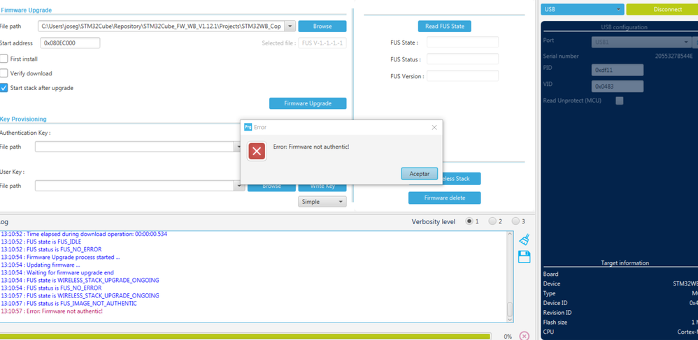

When trying to flash fus binary the same thing happens: Error: Firmware not authentic!
0693W00000DmX8aQAF.pnglogs:

  13:10:54 : Firmware Upgrade process started ...
  13:10:54 : Updating firmware ...
  13:10:54 : Waiting for firmware upgrade end
  13:10:54 : FUS state is WIRELESS_STACK_UPGRADE_ONGOING
  13:10:54 : FUS status is FUS_NO_ERROR
  13:10:57 : FUS state is WIRELESS_STACK_UPGRADE_ONGOING
  13:10:57 : FUS status is FUS_IMAGE_NOT_AUTHENTIC
  13:10:57 : Error: Firmware not authentic!

  13:16:47 : Error: FUS_STATE_IMG_NOT_AUTHENTIC
Javier1
Principal
Same error when trying v1.10.1 in addr 0x080CB000
09:45:45 : File download complete
  09:45:45 : Time elapsed during download operation: 00:00:00.675
  09:45:45 : Firmware Upgrade process started ...
  09:45:46 : Application is running
  09:45:56 : Reconnecting...
  09:45:56 : Reconnected !
  09:45:56 : Firmware Upgrade Success
After the correct FUS was in place now i could load
09:50:18 : File download complete
  09:50:18 : Time elapsed during download operation: 00:00:03.774
  09:50:18 : Firmware Upgrade process started ...
  09:50:18 : Application is running
  09:50:29 : Reconnecting...
  09:50:29 : Reconnected !
  09:50:29 : Firmware Upgrade Success

The mandatory steps to properly upgrade the FUS (and the the FW stack) is described in the releases notes of the wireless stacks under the \Projects\STM32WB_Copro_Wireless_Binaries\STM32WB5x directory.
The Mandatory steps didnt helped me at all and this is why:
What i think happened here is there is a hash identifying Fw versions, at some point of ST development that hash was changed, and now i need to flash an old FUS firmware -> to flash the new FUs firmware -> to flash the BLE stack firmware.
Remi QUINTIN
Please use the CubeProgrammer V2.8 version which ahs the "Start FUS" button and is able to read the FUS state even via the SWD port. This was not the case with version 2.6 or earlier.
Now the binary file to use depends on the GFUS version currently available on your board.
For this, you need to read the FUS version either via the User USB port in DFU mode or via the STLINK USB connector (=SWD port) but only with CubeProgrammer v.8.
One hint you can use is to read the SFSA option byte: If it is 0xF6, then it is v0.5.3. If it is 0xF4 then it is a more recent version.
If it is v0.5.3 then use the FUS_fw_for_fus_0_5_3.bin file. If not use the other one.
“Firmware not authentic�? error message can absolutely result from the fact that an old version of FUS is installed on your board with an old decryption key that does not match a new one used to encrypt the new FW stack .
