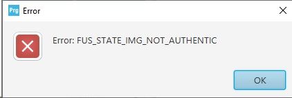

I just got my STM32WB55 Nucleo boards with FUS v.0.5.3 and trying to upgrade firmware but neither of the provided .bin files in "repository" ("stm32wb5x_FUS_fw.bin" or "stm32wb5x_FUS_fw_for_fus_0_5_3.bin") work. I get the same message for both when trying to program the files using STM32CubeProgrammer tool. (Note: message "Firmware Delete Successful" was present).
Attaching a picture of the error message I get.
Note: I tried to accomplish the same thing using both user USB DFU and ST-LINK interfaces.

10:45:12 : Error: FUS_STATE_IMG_NOT_AUTHENTIC

2021-10-04 8:15 AM
Imen,
IT WORKED!!!!!!!!!!!!!!!!!!!!! Thank you!!!!
2021-10-04 8:16 AM
Can you explain why this works, please?
2021-10-04 8:33 AM
Really glad that the issue is solved :smiling_face_with_smiling_eyes:
This is a trick to clean the flash that I used before upgrading the board, which helps to sort out from such unexpected situation;)
Imen
2021-10-04 8:39 AM
Good enough for an answer. I was more interested in the details because I'm suspecting there's a bug in the fw/sw(?) But it's up to the ST engineers to figure that out and "outsiders" shouldn't be involved in the direct resolution process.
Thank you, again.
