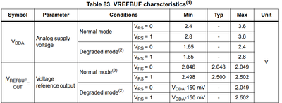

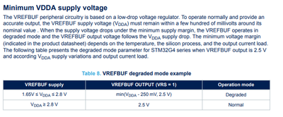

As you can see below which is taken from AN5690 Application Note, VREFBUF can be used in Degraded Mode if VDDA is lower than that value. In STM32WB55 Datasheet (Figure2), it states that it gives VDDA-150 mV as VREFBUF output which will be 1.55 for 1.7 V VDDA.
2024-06-14 8:39 AM
Right, but what is a "reference" good for, if its no more any exact reference voltage ????
Better dont play around with useless "reference" .
Same as using a resistor to VDDA . :)
So you could : use a 1.8V linear regulator for supply and vdda+Vref+ , ADC working and clear defined reference voltage; like LP2985-1.8 , 1,8V +/- 0,5% .
