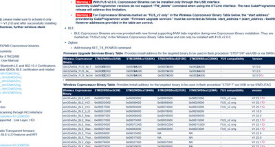

Have you followed those warning will updating the Wireless stack after updating the FUS to the version V2.0.0:
Warning 1: With FUS v2.0.0, Coprocessor Binaries can be installed only through the USB interface,
Currently CubeProgrammer versions do not support “FW_delete” command when using the ST-Link interface. The next CubeProgrammer release will address this limitation.

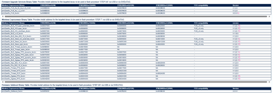

Warning 2: For Coprocessor Binaries marked as “FUS_v2 only” in the Wireless Coprocessor Binary Table below, the “start address” provided by CubeProgrammer under “Firmware upgrade services” must be corrected as follows: start_address = (start_address - 0x4000). However, addresses provided in the table are correct
If not, it may be the reason behind this issue.

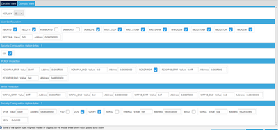

and where I can find default option bytes? It would be great if possible to set default in cubeprogrammer.

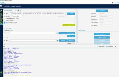

it worked for a short time. but after connecting stm32cubeprogrammer and see "Firmware Upgrade Service" and read FUS info, It is not working anymore. why it is not reliable. I did not anything. after programming flash again, it works. but it is not working again. :(
2025-05-28 1:35 AM
After Clicking on the read or start FUS. Or update the Wireless binaries, could you please try to click on the "start Wireless Stack" button .
Best Regards.
STTwo-32

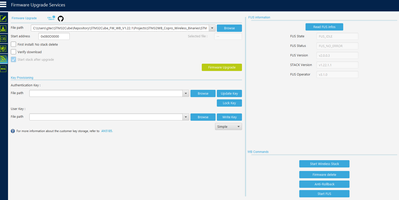

2025-05-28 1:54 AM - edited 2025-05-28 1:58 AM
I did all steps again. Should I press "Start Wireless Stack" after updating stack? I pressed this time and now it is working.
But after pressing "Read FUS infos", it does not work anymore.
I think "Read FUS infos" erases my flash. but why
2025-05-28 2:23 AM
After updating the stack, you may need to click on "Start Wireless Stack" button.
