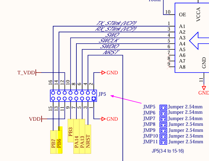

I'm really new to STM32 and everything that goes around... I want to communicate with a SIMCOM A7670E with my NucleoWB55RG and UART1. I'm using PB6 and PB7 for USART1_TX and USART1_RX. But these pins (I kept the jumpers) are also connected to TX_STlink and RX_STlink right? That's why I can print on a tera term terminal what is happening on the UART right? (I followed a tutorial with no explenations that's why I'm not sure).
My question is : is it a problem if I connect PB6 and PB7 on RX and TX of my 4G module? Maybe it will cause a conflict?

You're going to have to make choices..
Can you use SWV/SWO ITM_SendChar() for diagnostic output?
Or find some other free UART-TX pin you can wire over to the ST-LINK output channel?
Go through the pin mapping options in the Datasheet, enumerate the pins available to you

@Fannyrsy wrote:My question is : is it a problem if I connect PB6 and PB7 on RX and TX of my 4G module? Maybe it will cause a conflict?
Yes, it will cause a conflict.
You will be shorting your 4G module's TX output with the ST-Link's TX output - that will not end well.
As @Tesla DeLorean said, you need to consider options:
