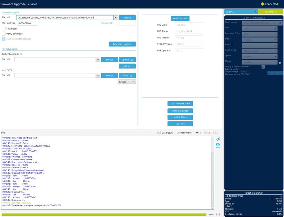

Then I tried to upgrade FUS with stm32wb5x_BLE_Stack_full_extended_fw.bin(Release v1.13.3) and encountered with the problems. I tried the upgrade with cubeProgrammer v2.10.0, v2.9.0, and v2.8.0, and it returned the same results.

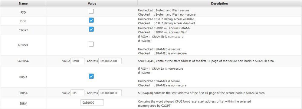

Also, I found some strange things at option bytes. The SNBRSA and SBRSA have different values and addresses from NUCLEO55USB-DONGLE. Here is the picture.
Any suggestions to fix this issue ?

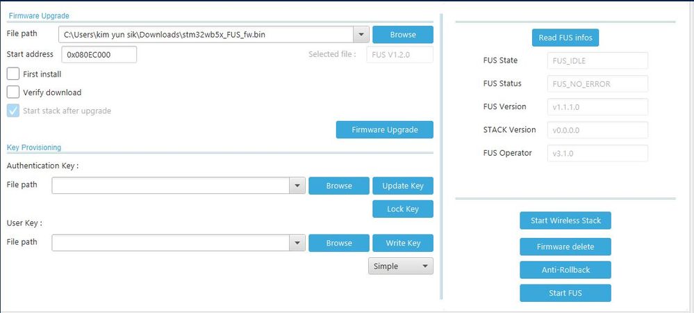

After and before the upgrade the fus infos was as following picture.

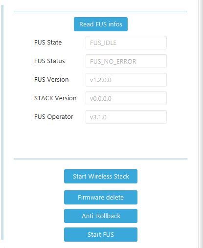

2022-06-21 12:43 AM
I followed your advice and upgraded FUS to v1.2.0 successfully.
However, when I tried to upgrade BLE stack, the following error was occured.
