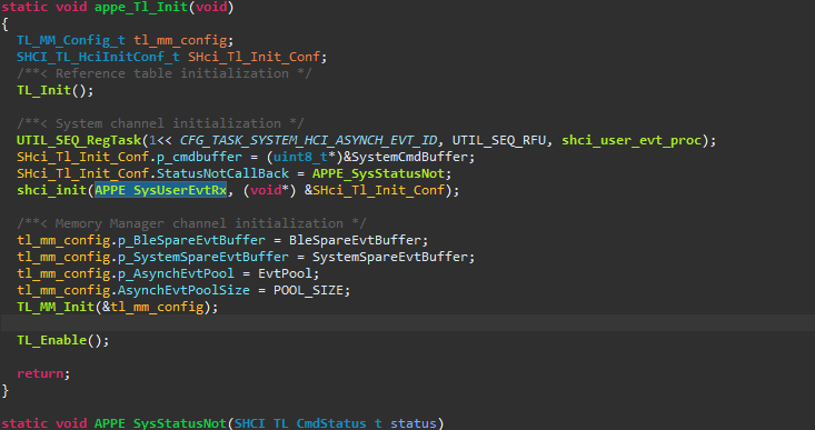

APP_BLE_Init(void) (app_ble.c) was never called because the function where it was called in was registered as a Task but never set.
Function calls were as follows:
It is important to notice that projects created with firmare 1.14.1 and migrated to 1.15.0 did not have this issue and worked like before.
Just projects created on the 1.15.0 firmware showed this issue. I created mutliple (8) projects and tried different BLE configurations, all with the same issue.

Which version of BLE Stack are you using? When the issue occurs did you received the ready event from CPU2 (SHCI_SUB_EVT_CODE_READY) or not? Where is stuck the code when the issue occurs?

Where can I see the SHCI_SUB_EVT_CODE_READY?
The code is not stuck at all, just the functions mentioned above are never reached and therefore the BLE is not initialized. The main loop runs fine.

With the stm32wb5x_BLE_Stack_full_fw.bin, if you generate a P2P Server, is it working?
You can see the SHCI_SUB_EVT_CODE_READY event in APPE_SysUserEvtRx function see app_entry.c file.
