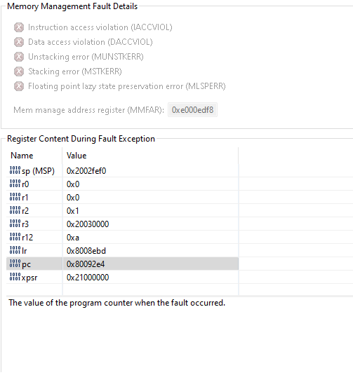

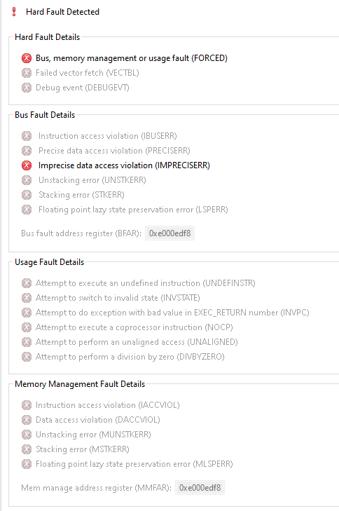

When I tried debugging following is the traces
I didn't understand this problem, can someone please explain this? and how to solve this.

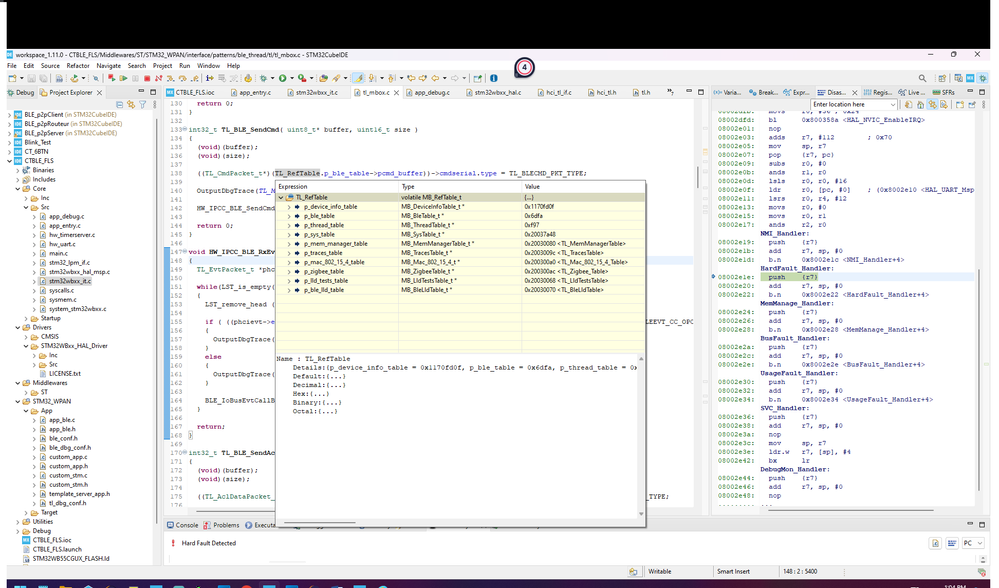

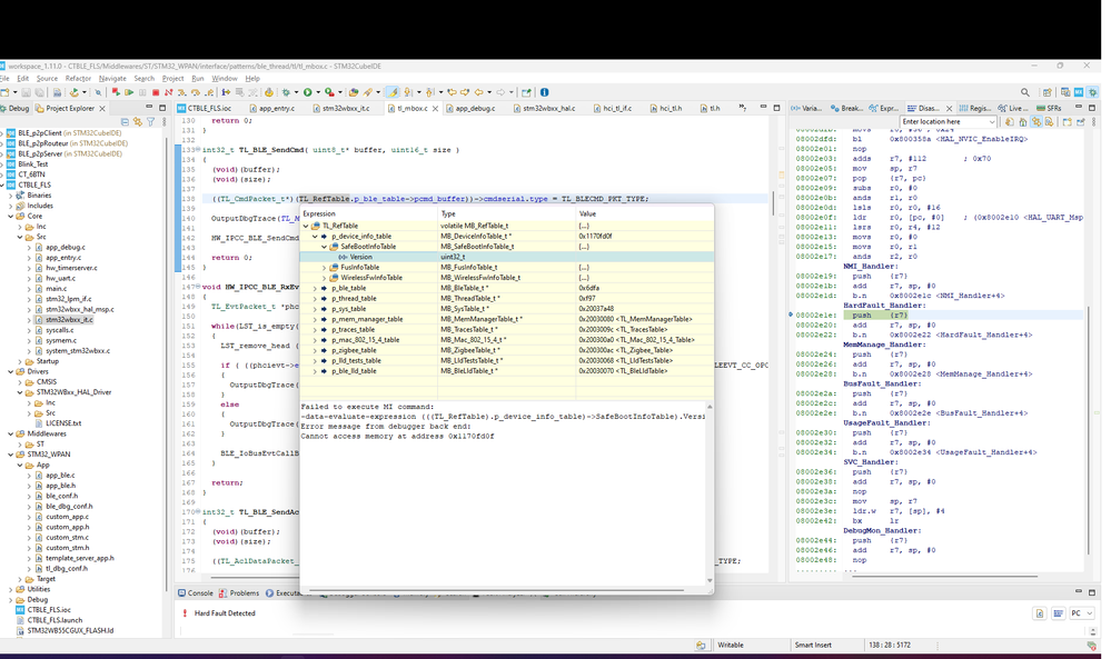

According to your screenshot, the CPU2 is in hard fault as you can see at @0x20030000 (SRAM2A_BASE) you have the hard fault keyword. In most of case, the CPU2 hard fault occurs when the CPU1 corrupts the flash memory and then when the CPU2 try to access to the flash, it generates the hard fault.
Can you confirm that you are using the BLE Full stack v1.16.0.4 as you said in this post?
When the hard fault occurred, can you check flash register value (FLASH_C2SR (CPU2) and FLASH_SR (CPU1) register)?
