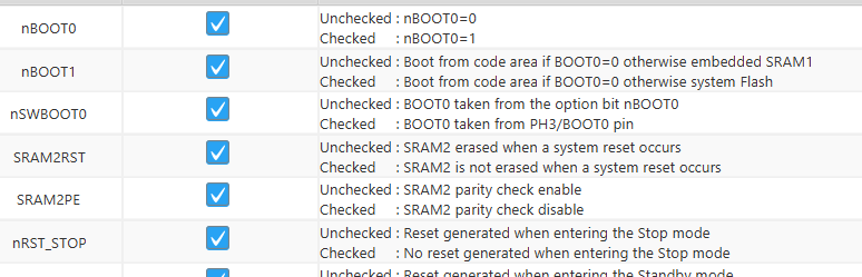

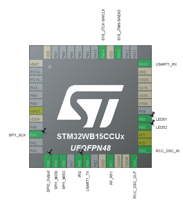

The BOOT0 pin is on GND via a 10kOhm resistor, this is my pinout from the IDE: I looked up the Option Bytes via the STM Programmer and they all seem to be set correct, as described in the boot process FAQ.

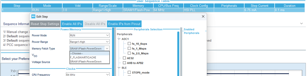

Does the Memory Fetch Type have anything to do with from where the MCU boots during a normal boot process and if so, do I have to set it to F_FLASH? It is currently set to SRAM1.
