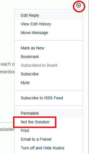

@Nixxen wrote:
I did not intend to accept this as a solution.
How to unmark the solution:

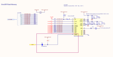

when rebooting we cut the power for 2-3 seconds on the whole board so this shouldnt be an issue. I attached our Flash-Schematics. We later added a connection betweenn the MCU NRST and the Flash-Reset Manualy which is not shown in the schematic.

Hello @Nixxen ;
After checking your schematic, your aren't used a reversed diode to each of all external RESET pins of external memories as recommended in Getting started with hardware development for STM32N6 MCUs - Application note.
I recommend you to correct this issue by adding a reversed diode. Please let me know if the issue is solved or not?
I advise you to refer to Nucleo-N657X0-Q schematic and check your schematic.
