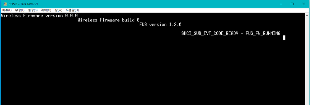

I checked what is happening in the microcontroller using USART communication, but there is no wireless firmware version (It was 1.0.0 in the Nucleo-WB55 board) and no message regarding starting advertisements like below.
Is there any possible reason it does not work?

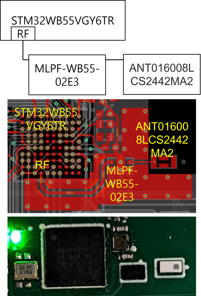

My RF structure in the custom board looks like below.

The firmware for FUS and BLE stack is upgraded using STM32cubeProgrammer and must start "Start wireless Stack".
Following this video: https://www.youtube.com/watch?v=1LvfBC_P6eg&t=4s
Then, the BLE advertisement and wireless connection will work very well.
Thanks to all of you guys.
