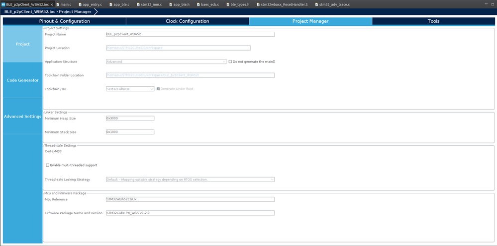

2024-02-15 7:23 AM
In the bottom of your screenshot, we can see that your project still uses v1.2.0.
2024-02-15 7:26 AM
But how can I use the 1.1.1? I used the .ioc file in the Github link that you provided and it still generates 1.2.0 version on the project.
2024-02-15 4:38 PM
Even if I delete the firmware files and replace them by version 1.1.1 the STM32CubeIDE automatically downloads the 1.2.0 version and replaces it, making it Impossible to use that version.
