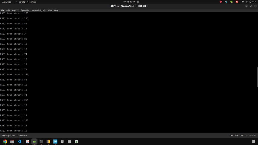

Hello, I am working with STM32WBA52CG as a central and I want to read the RSSI from the incoming advertising packets. The RSSI value should be a negative value in dBm, however it is defined as uint8_t in the AdvertisingReport_t structure. Can someone explain me how to get the correct RSSI value? I am getting the values shown on the terminal below.

uint8_t rssi = p_adv_report->Advertising_Report[0].RSSI;
LOG_INFO_APP("RSSI from struct: %d , ", rssi);

If it is just a byte, a value such as 74 does not make sense. As per chip documentation there is no clear information about this RSSI value interpretation.
