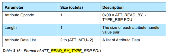

The ACI_ATT_READ_BY_TYPE_RESP_EVENT event contains the handles and values of the attributes that have been read and has the following structure:
The length (e.g Handle_Value_Pair_Length) corresponds to the size of each element of the attribute data list (e.g Handle_Value_Pair_Data).
Each element of the list have the following structure:
For example for Generic Access Service, we have the following values:
Handle_Value_Pair_Length = 7
Handle_Value_Pair_Data =
