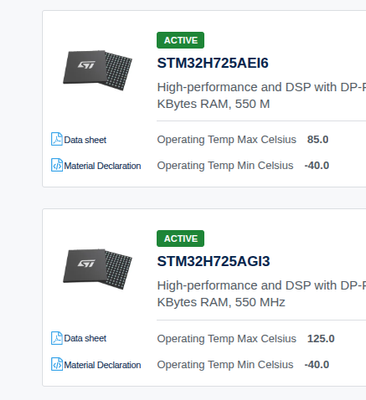

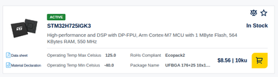

read:
on webside...see in e-store , but only view chips in the -3 class:
