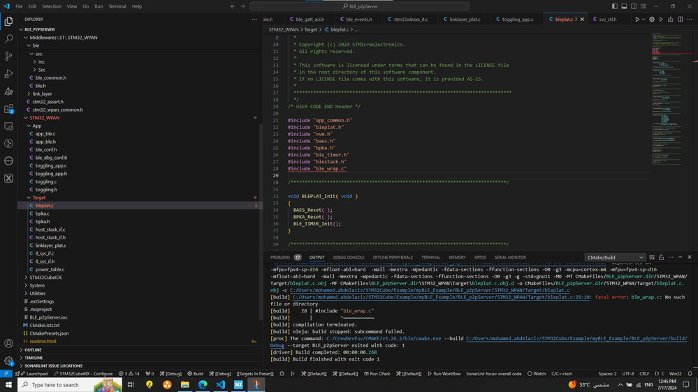

Iam using STM32WBA55 and i tried to configure STM32_WPAN BLE application but the generated code has a file not found error.
ask me for any further details regarding this problem because i don't know what to put in my post that might help in this problem.

I'm using STM32Cube MCU package for STM32WBA series v1.4.0. Iam using STM32CubeIDE not vs extension. i solved this problem by selecting the option "copy all used libraries into the project folder" in my STM32CubeMX project and it compiles and working good.
2024-07-23 12:50 AM
it also compiles using Makefile as well as CMake with VS code without any ST extension.
