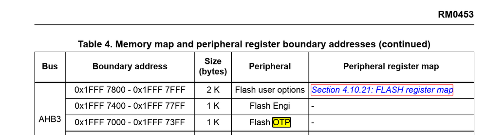

2024-07-22 10:57 AM
I don't know specifically for the WL55 chips, but there is usually an OTP section (one-time programmable) that is available, typically in the 0x1fff7xxx area (after the internal bootloader). If you don't want to use that (or if it is too small), then any area of flash that is not used by your main program or in-circuit code updater.

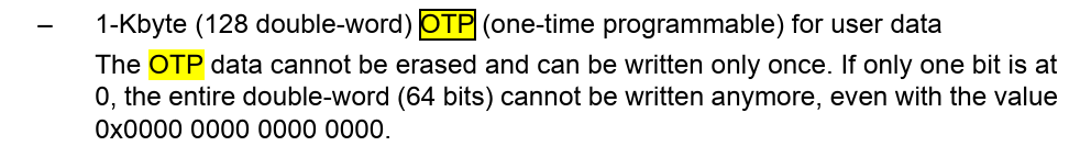

2024-07-22 11:10 AM
OTP area seems perfect for this, see rm:
