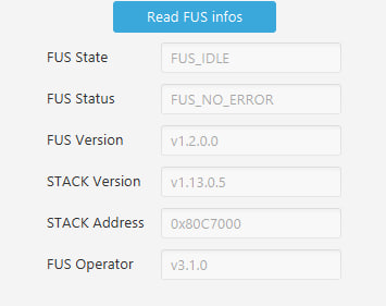

I got this on both boards
2025-10-13 5:27 PM
Hi
Just a quick update and a follow-up question. A huge thanks to you, your hint was spot on. As always, you're the best on this!
I managed to get the BLE running on one of my boards. I flashed it with stm32wb5x_BLE_Stack_full_fw.bin v1.13.0.5, and it worked. The newer v1.22 and v1.23 stacks wouldn't flash.
My question is, should I be worried about using this older stack? It would probably be good to have a newer version, right?
Do I have to update my FUS to use them? If I understood correctly, there's a warning about FUS v2.0 forcing updates over USB. What's the latest version I can safely upgrade to and still be able to flash everything with my J-Link?
