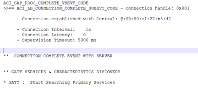

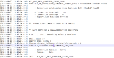

I'm working on custom BLE Central and Peripheral project to make connection and send some sensor data over BLE. For this I'm referring to BLE p2pServer and p2pClient along with p2pRouter example projects. I'm able to make a connection with the server, but immediately I get HCI_DISCONNECTION_COMPLETE_EVT_CODE with the error code for reason as 0x3E. Can anyone help me out with this.?
Attaching the snapshot of the debug messages.

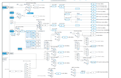

2. Snapshot of the clock config of Central device.

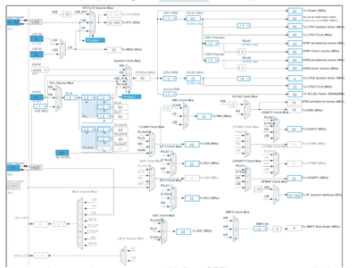

3. Snapshot of clock config of Peripheral device.
