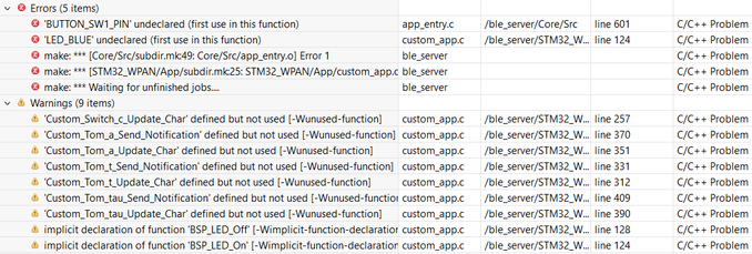

I have been following the tutorial STM32CubeMX Application Conception for making a custom BLE server with my P-Nucleo-WB55. I am using version 6.9.2 of STM32CubeMX. Everything works until section 7, where server notifications and write management with GPIO are configured.
The tutorial uses BUTTON_SW1_PIN and LED_BLUE macros, which do not seem to exist. The tutorial also uses BSP_LED_ON() and BSP_LED_OFF(), which I cannot find declarations for. What should I do?
Perhaps this is a silly issue with a quick fix, but I am concerned that STM32CubeMX is changing the structure and organization of their code generator. If this is the case, would you suggest rolling back to the 6.4.0 version (which the tutorial has success using) of the STM32CubeMX and sticking with that same version for development?
Any help will be appreciated. Thank you.

Hi RCM1,
Which version of STM32Cube Firmware Package are you using, please?
Joé
2024-03-07 6:42 AM
I am using the latest available version: 1.17.3
