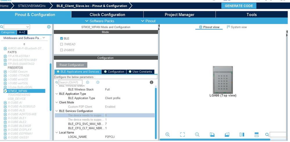

        In my project I'm using STM32WB5MMG MCU for BLE Server and Client.

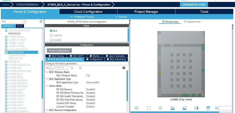

BLE Connection between p2p Server and p2p Client is working well but I want connect Custom Templete Server with p2p Client.
In this case Server and Client are not connected also both are maintained in IDLE condition, So anyone give me a solution to this issue.
P2P ClientP2P ClientCustom Templete ServerCustom Templete Server

Hello @Kavinraj
Could you try to enale the Custom P2P server on the Server side.
Best Regards.
