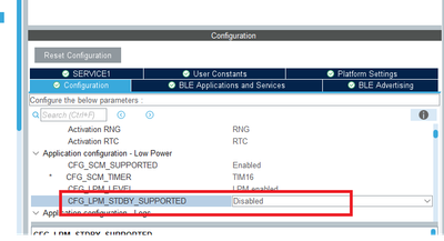

I have disable "CFG_LPM_STDBY_SUPPORTED".

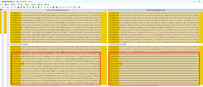

I compared the images built with CubeIDE and IAR, and observed that the image generated by IAR contains almost all 0xFF data starting from address 0x20806000. Could this be the root cause of the Bluetooth connection failure?
