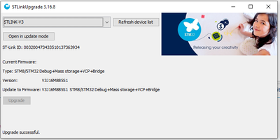

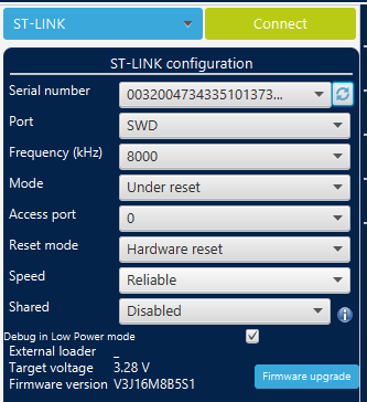

Hello, thank you for the reply.
In CubeProgrammer, it lets me update the firmware but when trying to connect under reset (at the same time pressing the reset button) the error "Unable to get core ID. No STM32 target found." appears.
