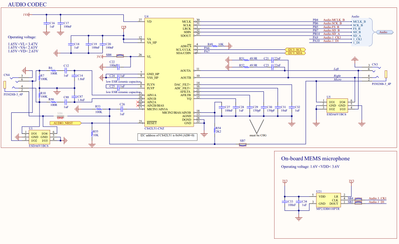

This example should be able to run on all STM32WBA55xx. But it has HW depends that are not implemented on the Nucleo Board Specially the Audio Codec part:
Best Regards.

If you are not going to add the external features mentioned above, you should use the DK boards to run those examples.
Best Regards.
