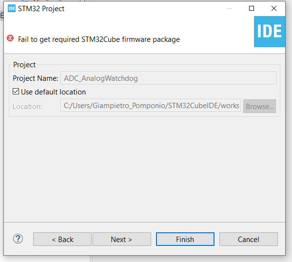

I'm trying to import an example project for STM32WB using STM32CubeIDE V1.5.1
and got the following error:
I tried doing package updates, uninstall and reinstall and everything I could think of but I wasn't able to figure out how to resolve this (tried googling/forum searching it but no luck).
Following I report you the Package installed:
How can I resolve this issue?

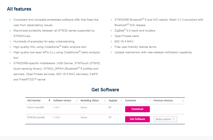

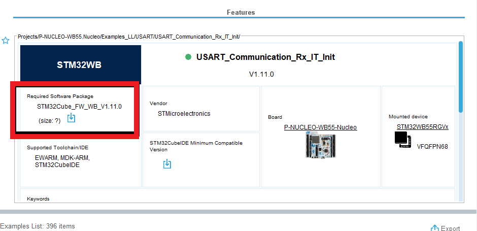

2021-02-20 7:17 AM
I've done other tests without success.
I've noticed that the required software package is 1.11.0
But the lastest release downloaded from the ST'site or STM32Cube is 1.10.1:
someone has the same problem? Any ideas to solve this problem?

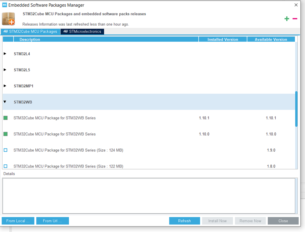

2021-02-22 8:13 AM
Hi Khouloud ZEMMELI,
many thanks for your support.
I open STM32CubeIDE and click to Help->Manage Embedded Software Packages.
After I click on the button 'Refresh'. The procedure go on without error (I don't have connection problem) in fact I've seen that the download procedure is done but the last release downloadable for the series STM32WB is 1.10.1 yet.
Is it right the procedure that I've done?
Thanks for your contribution,
Giampietro
2021-02-22 8:19 AM
Hi again @Community member ,
Yes, everything is ok, the STM32WB 1.11.0 firmware version will be available for the next CubeMX and CubeIDE releases.
Khouloud

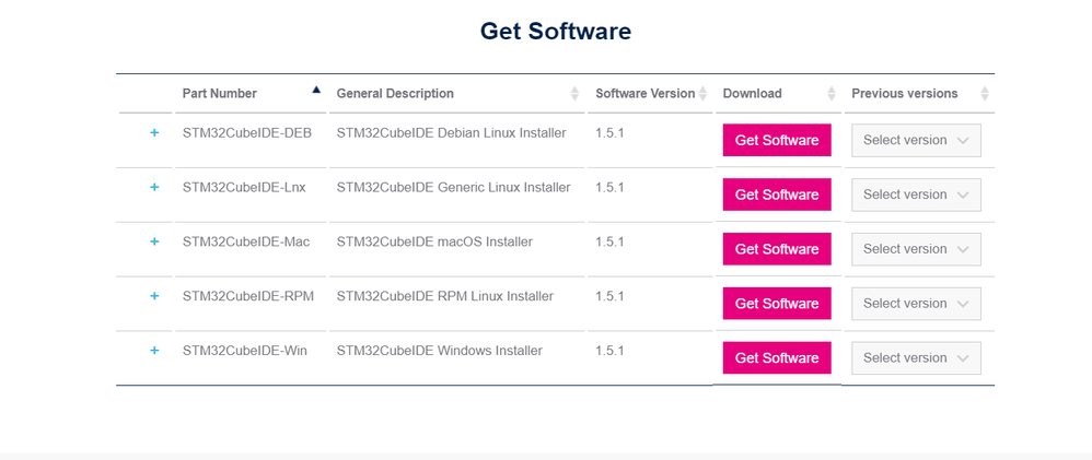

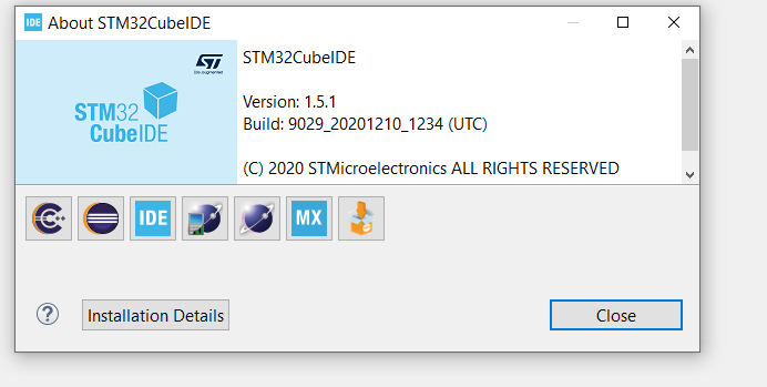

Hi again Khouloud ZEMMELI,
When the new release for CubeIDE is available?
I've now checked the last downloadable is 1.5.1 (my current version) yet.
Giampietro
