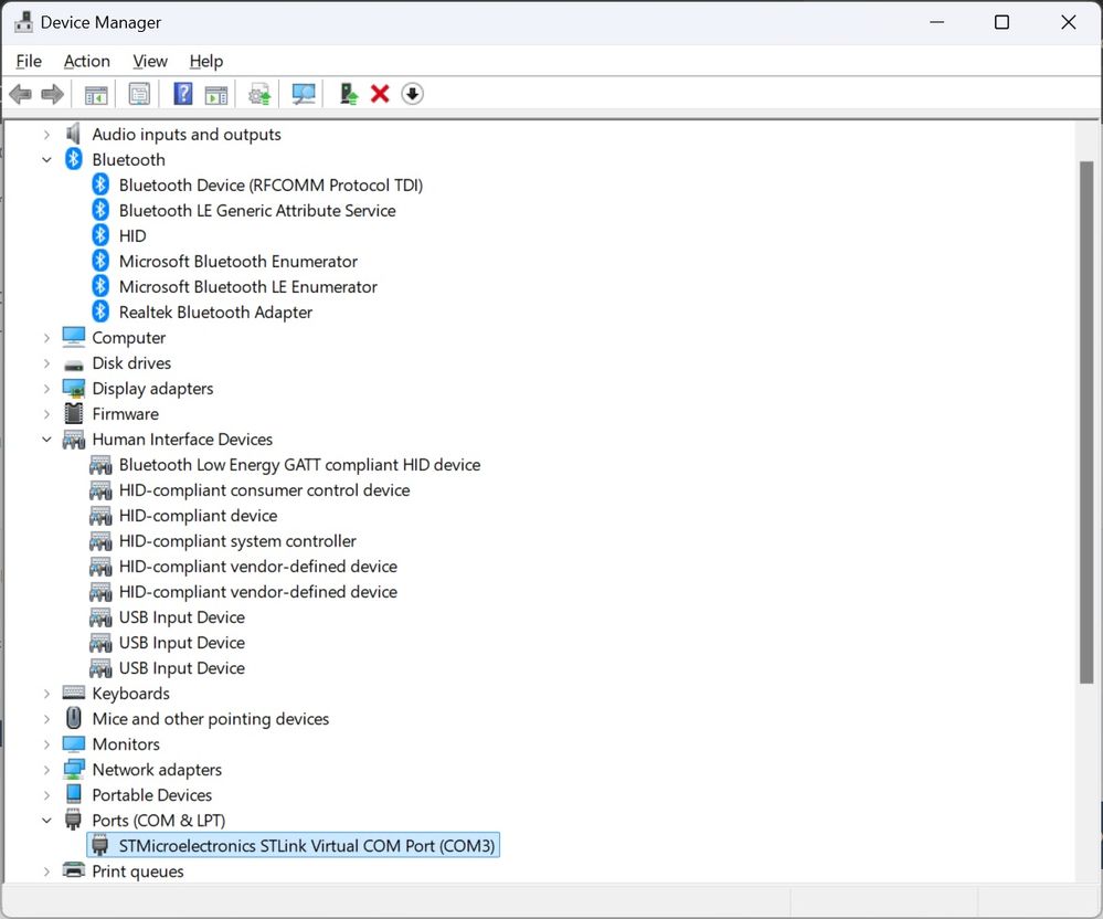

*** pressing switch SW1 - nothing happens!
Why something should happens on a terminal window connected to COM3 STLink ?

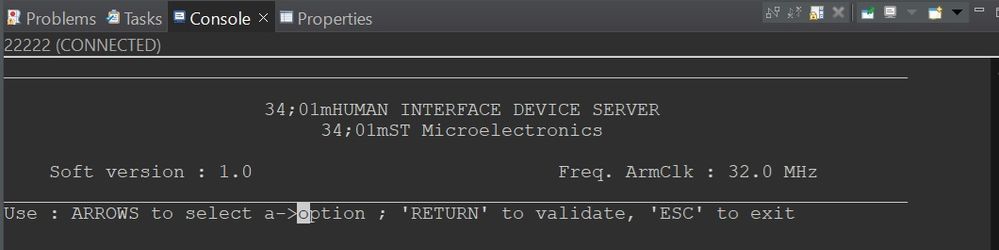

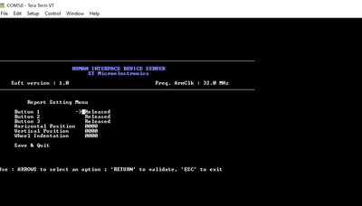

Hello @GS2
When clicking on the SW1 Button, you will see this on the Serial monitor:
Best Regards.

Nothing happens in terminal window after pressing switch SW1!

So now I have 3 questions:
1. is it possible to change PIN code from "111111" ?
2. Why something should happens on a terminal window connected to COM3 STLink ?
3. After pressing SW1 - I have the follow:
