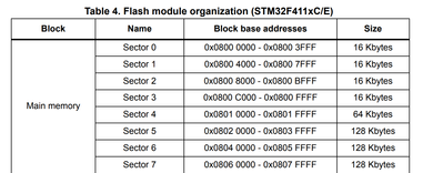

Can you try using the STM32Cubeprogrammer, without uploading the .hex file, to Erase Sector by sector at alone and then just Write a word like this 0x5555_5555 at start of each sector. In this MCU, we have only 7 sectors, so the test is simple. then Let's see the .log for all operations, but go sector by sector and not all at once or many at a time.

On a 512KB device, highest writable address would be 0x0807FFFF
