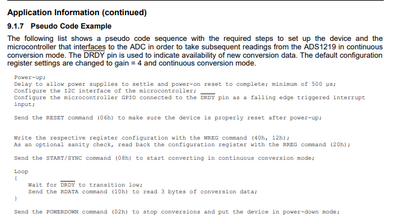

Hello, I am attempting to communicate with TI's ADS1219 via I2C from a STM32WL55JCI, I know the I2C works becuase I can use the same line to write/read from a FRAM chip. Unfortunately, the ADS1219 communication always results in a HAL_FAIL status.
No matter if I send a reset command
HAL_I2C_Master_Transmit(&hi2c2, 0x80, 0x06, 2, 10);Or if I probe the device.
HAL_I2C_IsDeviceReady(&hi2c2, 0x08, 10, 20)Can anyone offer any insight?

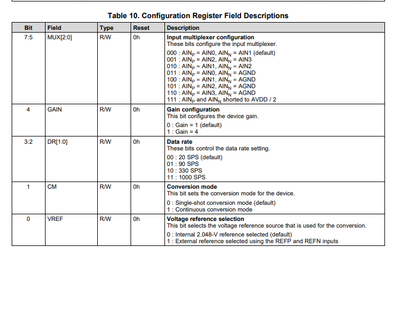

I had them configured to default and followed the steps outlined in the pseudo code.
2024-01-02 4:07 PM
@sgtaylor The question was, are the address pins A0, A1 set correctly? Not about the configuration register.
