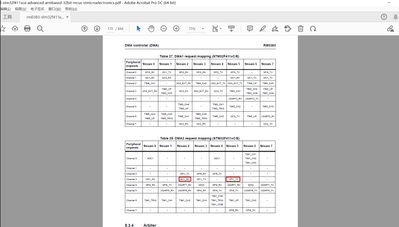

I found the DMA request mapping of the F4 series on ST's official website. With this form, I can configure DMA on zephyr.
My problem is that I cannot find the DMA request mapping of STM32WBA52CG. Can you provide me with one? Thank you.
The device tree file requires channel and request parameters.

2024-01-03 1:21 AM
the table may like this which belongs to F4 series.
