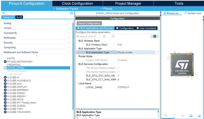

To guarantee that both BLE_CFG_PERIPHERAL and BLE_CFG_CENTRAL macro still be set to 1, you should set the BLE Application Type to Router profil on your CubeMX .ioc file:

Thank you for your response. I had configured the following settings in STM32CubeMX:
  • Peripheral: Advertise and connectable → Yes
  • Central: Scan and connect → Yes
(as indicated in the following wiki: https://wiki.st.com/stm32mcu/wiki/Connectivity:STM32WB_BLE_STM32CubeMX)
However, every time I make a change with CubeMX and update the code, I notice that:
  • #define BLE_CFG_PERIPHERAL remains set to 1
  • #define BLE_CFG_CENTRAL reverts to 0
This means I hadn’t realized that BLE_CFG_CENTRAL was actually 0. I must have misunderstood something. How can I ensure that BLE_CFG_CENTRAL remains set to 1 even when updating the code with CubeMX?
Hello @Francesco1234
Best Regards.
