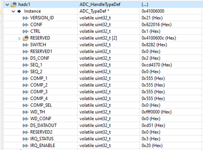

ADC register settings:
Finally, note that COMP_x registers are at default values.
And indeed, I didn't find any documentation about estimating COMP fields: OFFSET and GAIN;
it would be possible having a GND and VREF input capability, which I didn't find, either.
