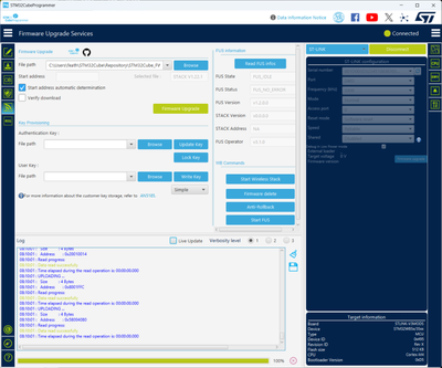

2025-08-15 7:11 AM
Here is what I get when I read the FUS
2025-08-15 7:13 AM
I tried again using the other repository I had downloaded, 1.17.2, and it worked. I noticed that it was programming sectors 90 to 127 with that stack using the start address automatic determination. I think there is something wrong with the 1.22.1 full stack binary.
