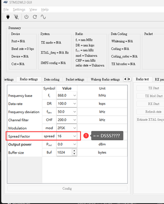

Hi Saverio.
Regarding the DSSS setting, is it the Spread Factor in the GUI?
2025-01-28 1:46 AM
Hello Weili,
Yes, It is the Spread Factor.
