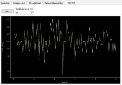

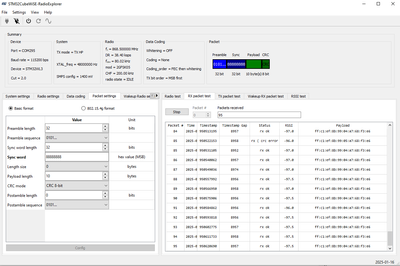

We started to analyze your problem. First, we checked the sensitivity in conducted mode with the same radio configuration to verify the receiver's performance. The value we measured is -106 dBm, which is in line with our expectations. Then, we tested our kit in radiated mode using the same antenna we provide with the board and measured a noise floor close to what you measured, in the range between -110 to -105 dBm. Considering an SNR of around 8 dB, we expect to start losing packets with an RSSI close to -100 dBm. Indeed, the plot below shows that we start to lose packets with power lower than -97 dBm. This is coherent to me. I would expect to see the same behavior in your side, but you started to lose packets at -84 dBm, which is far from both the noise floor and sensitivity.
Noise floor
Packet received at -97 dBm

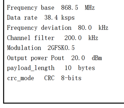

In order to understand better the cause of this behaviour I need to have more details on the RF parameters used (TX power, data rate, frequency deviation and channel filter).

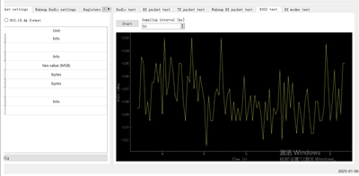

Then the tx power is measured by spectrum and is about 18-19dbm@CW
RF parameter as below.
background noise as below.

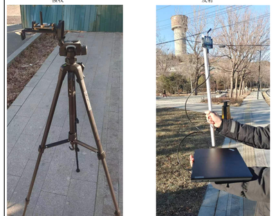

the distance about 160M,

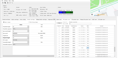

Sent 100 packets and received about 10 packets.
