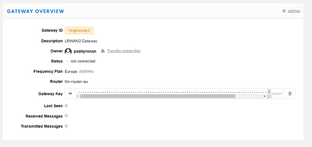

I am quite new to LoRa so if I am in the wrong forum area I do apologise. If anyone has any information based on my issues below I would appreciate a reply.

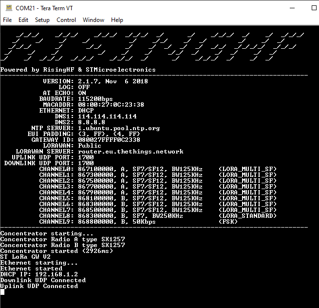

I have followed the setup guide from STMicroelectronics for the P-Nucleo-LRWAN2:
I have loaded the following bin file to the gateway: st-nucleo-lora-gw-at-fw-v2.1.7-eu868-TTN.bin
I have loaded the I-NUCLEO_LRWAN1 with the AT_Master firmware as instructed.
